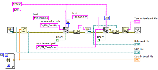

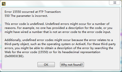

I'm using FTP to transmit files but I got the error 15550 when using FTP Put File.vi as follows:
Error 15550 occurred at FTP Transaction: 550 The parameter is incorrect.
The Remote Write Path of FTP Put File.vi should be the file path instead of directory path on the FTP server.  This is the same for the Remote Path of FTP Get File.vi.
