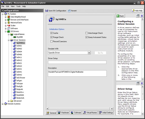

A GPIB interface can be simulated in LabVIEW, but not in MAX. The following example shows how LabVIEW can be used to simulate a GPIB Device: Archived: Simulating a GPIB Instrument in LabVIEW .
It is possible to simulate instruments using IVI drivers in NI MAX. In order to achieve this you will need to Configure an IVI System In Measurement & Automation Explorer (MAX) . In order to simulate a device, you can specify the driver in the General tab in MAX as seen below:
There are tools that can create virtual COM ports that you can use to interface with, nevertheless, those are not supported by NI and we cannot guarantee they will work as intended. Utilize these tools at you own risk.
