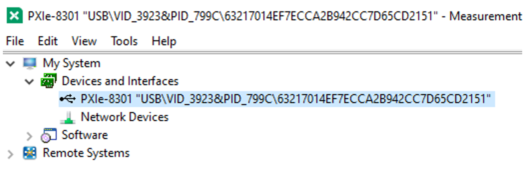

  • I can see my PXIe-8301 Thunderbolt Interface in NI-MAX, but I don't see the PXIe Chassis or the PXI(e) Peripheral Modules associated with this system. The Link LED on the PXIe-8301 is Solid Amber. I'm using a USB-C cable and port – Why can't I interact with my PXIe System?

If you are using a USB-C port or cable, NI-MAX may identify your PXIe hardware as USB, as shown in the picture below:
  • USB-C is a connector type, not a data bus. Both the USB 3.x Specification and Thunderbolt Specification leverage USB Type-C as the connector form factor; however, the Thunderbolt Specification has other capabilities built on top of the USB 3.x Specification, such as higher throughput, bidirectional PCIe, and DisplayPort lines. Because of this, while you can see your Thunderbolt Remote Controller, it is unable to connect since it does not have the proper data transfer mechanisms.
