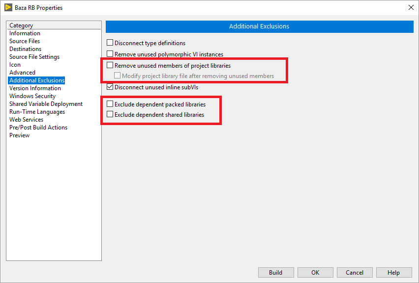

We have an application which contains the base class for dynamically dispatching the plugins during run-time.
When the application tries to launch the dynamic VI we are getting the error as shown:
For you to overcome the issue, follow the mentioned points:

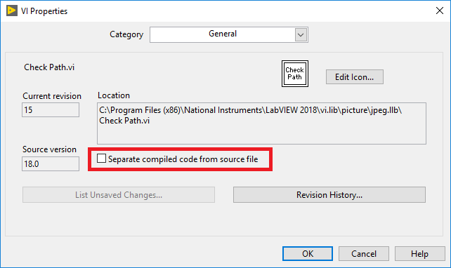

  • Uncheck Separate compiled code from source code parameter in the specific VI properties.
  • Include in stand-alone application all of the function dependencies from the project by unchecking marked parameters bellow.

    • For LabVIEW versions older than 2011:
      • Separating compiled code from the graphical VI source code is an option in VI Properties >> General. If you enable this feature, there are benefits like
        • Smaller VI size on disk
        • Unnecessary check-in and check-out of top level VIs in source code control if the subVI is edited.
      • It should be noted that the LabVIEW Runtime Engine will be unable to dynamically call and run standalone VIs with the above option checked because the Runtime Engine will have not have access to the compiled code.

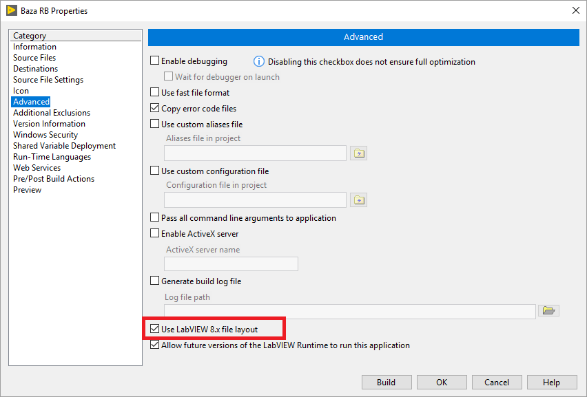

  • For LabVIEW 8.x version project it's necessary to check Use LabVIEW 8.x file layout property in build specification in order to call these VIs from a newer version of LabVIEW
