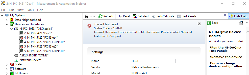

  • I have an NI PXI Oscilloscope card and my device fails the self-test in NI Measurement & Automation Explorer (MAX) and NI-Scope Soft Front Panel with one of the error codes below:
    • -200284
    • -200313
    • -200550
    • -228858
    • -238801
    • -239000
    • -239001
    • -239020
    • -239022
    • -50550

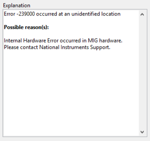

An example of the error message I see along with the code is listed below:
Error -239000 occurred at Self Test
Possible Reason(s):
Internal Hardware Error occurred in MIG hardware. Please contact National Instruments Support.
  • Oscilloscope device appears two times NI MAX and there is a red circle next to the device icon
239020 error
These error codes indicate fairly general problems that can be caused by either hardware or software. If you have a MXI system please check the additional steps below.
You can resolve these errors through one of the troubleshooting steps below:
