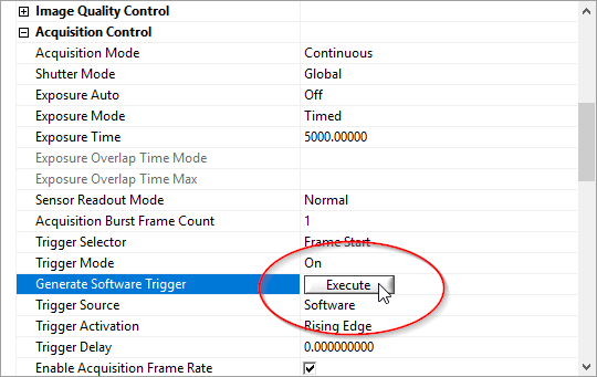

Using NI MAX
  1. Open NI MAX from the Windows Start menu and click on your camera under Devices and Interfaces.
  2. Click on the Camera Attributes tab.
  3. In the Attributes table, navigate to Camera Attributes»Acquisition Control.
  4. Set the Trigger Source attribute to Software.
  5. Click on the Generate Software Trigger attribute to show the Execute button as shown in the screenshot below.
  6. Clicking Execute will send a software trigger to your camera.
