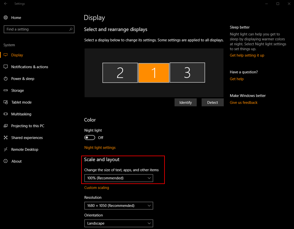

There is a known issue with versions of LabVIEW and LabWindows™/CVI, on Windows 10 where the UI will behave incorrectly when extended monitors are set to differing magnifications from the primary monitor. This can also happen if the primary monitor is a higher resolution than the extended monitors. Check your magnification settings. Ensure that they are uniform for each of the monitors.
To address this issue, try the following suggestions:
  • Right-click on the Desktop and select Display Settings scroll to the Scale and Layout Section and adjust scaling and resolution for each screen, preferably to a lower value. For example: change it to 100% if you have it at 125% or 150%.
  • Set scaling within LabVIEW™ or LabWindows™/CVI to be defined by the application
