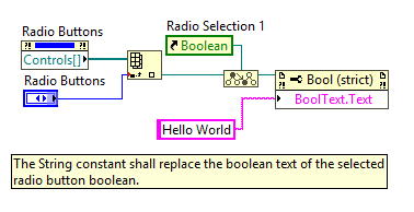

Is it possible to use a reference to a radio button to change the controls Boolean text?
Yes. To do so you will need to use the 'To More Specific Class node' to access the 'boolean property' of that control. See screenshot and attached VI for example.
