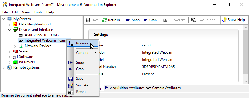

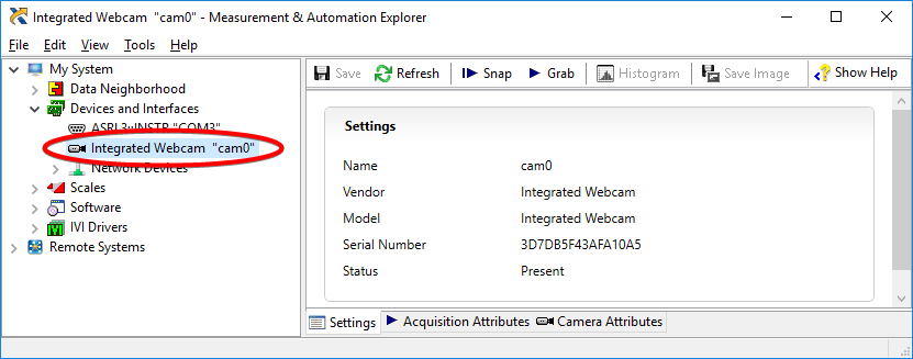

A camera needs to be set up in NI Measurement & Automation Explorer NI (MAX) first:
The camera's name in NI MAX is how the camera is referred to from within LabVIEW. This name can be changed in NI MAX by right-clicking the corresponding entry and then selecting Rename...:
