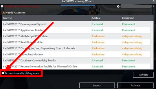

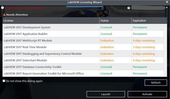

  • Every time I launch LabVIEW, the LabVIEW Licensing Wizard is showing me a warning for all the evaluation software or asks me to activate software I don't have or I do not need to activate. How can I hide the Licensing Wizard to stop it from requesting me to activate versions I do not need?
  • I installed several NI software and configured NI License Manager to point to a VLM Server . Some installed products (which I had not activated) are still in evaluation since they are not included in my assigned license.
  • The LabVIEW Licensing Wizard dialog is always displayed every time I want to use my software.

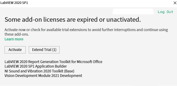

This pop-up is meant to remind you that your software is close to expiring or expired already.

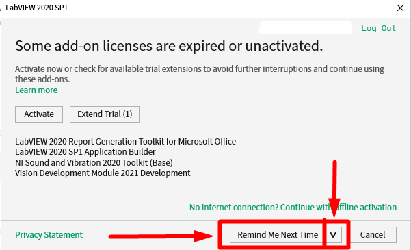

If you still need to use any of the software or toolkits you should probably click the Remind Me Next Time option if you are using a recent NI License Manager version, or leave unchecked the Do not show this dialog again checkbox in legacy versions, and then search for alternatives to activate your software refer to Activating NI Software Products if you need information on this.
If you don't need to use any of the software shown in the pop-up, you can go to the dropdown menu next to Remind Me Next Time and choose Do Not Remind Me, or check the Do not show this dialog again checkbox this would prevent the pop-up from appearing the next time you open LabVIEW.
If the LabVIEW Licensing Wizard dialog keeps getting displayed even after checking the Do not show this dialog again option, or If you do not see the option checkbox in the dialog. Refer to the specific section depending on your type of license and follow the next steps.
