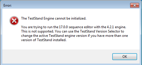

  • I have multiple versions of TestStand installed. When I try to launch the TestStand Sequence Editor, either nothing happens, or I get the following error: The TestStand Engine cannot be initialized. You are trying to run the [x.y.z] sequence editor with the [x.y.z] engine. This is not supported. You can use the TestStand Version Selector to change the active TestStand engine version if you have more than one version of TestStand installed.

The error message shown in the Issue Details section above can be fixed by opening TestStand Version Selector and making the desired version active. The error message results from attempting to open a version of TestStand that is not currently active. The error message shows which version is currently active and which version you are trying to open. In the case depicted above, we are trying to open TestStand 17.0.0 while Teststand 4.2.1 is marked as active.
