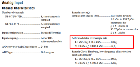

On some devices, such as the NI 4472 and NI 4461/4462, the oversample clock rate is based on the requested sampling rate. Other devices, such as the NI 4464 and NI 4480/4481, have a constant oversample clock rate regardless of the requested sampling rate, and is equivalent to the modulator sample rate provided in specifications documents.
As an example of a device with a variable oversample clock, on the NI 4472 the oversample clock runs at exactly 128 times the desired sampling rate when the sampling rate is 51.2 kS/s or less. At rates greater than 51.2 kS/s, the oversample clock runs at 64 times the sampling rate. Thus, at 51.2 kS/s or 102.4 kS/s, the oversample frequency is 6.5536 MHz (51.2k * 128 = 6.5536M, 102.4k * 64 = 6.5536M). These rates dictate some fundamental characteristics of the digital filters, as described in the NI 447x Specifications, look at the figure below.

For synchronization between the NI 4472 and NI 4461/4462 sharing the oversample clock is an essential step in obtaining synchronization with very little phase difference between two or more devices. However, the actual clock signal that is shared by both the PCI and PXI versions of the 4472 is actually twice the oversample rate.
Thus, the clock on the PXI_Star bus in a synchronized 4472 acquisition may be as high as 13.112 MHz. If you import this signal from a counter, for instance, you must then divide it by either 128 (Fs > 51.2 kS/s) or 256 (Fs = or < 51.2 kS/s) to obtain the DSA device sample rate.
