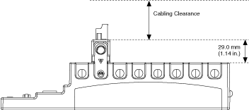

How much clearance do the different types of C Series module connectors require for cables and backplanes?
The cable clearance varies depending on the C series module connector you use. Cables and backshells require sufficient space to prevent crimped cables, which can distort measurements.
The following table shows the amount of space required for each type of C Series module connector:
